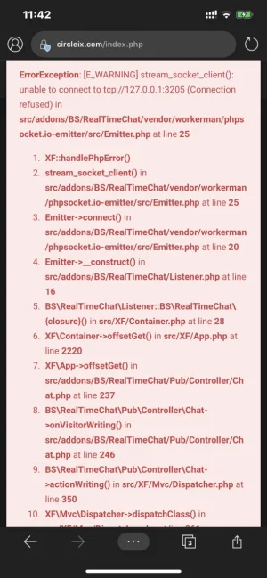

.https://xenforo.com/community/resources/bs-real-time-chat.7439/field?field=faqnow what?![]()
.you can send me access to the server and to the admin panel in private messages or Telegram. And I will help set up the add-on.i read the faq but i dont understand it and the link wont work
.because you need to start the chat server
.everything is written in the FAQhow the esyest way do i do that?
@Sweden, I do not recommend giving any data to this user.
.updatedTried to see demo, but for some reason when I try username user and password user, it doesn't work...
.connect to your forum by SSH and run this commandsI am going to assume this is my issue. If you could just guide me in the right direction I would appreciate it!!
cd {path_to_your_forum_without_braces}
php chat_start.php start -d
Code:cd {path_to_your_forum_without_braces} php chat_start.php start -d
.this means that several versions of php are installed on the server and you are running the script under the old versionI just got off with my host and had them update the php and I still cant get it to work "PHP 7.0.0 or newer is required. 5.6.30 does not meet this requirement." is the error I get and I just had that updated.
.PHP versionxenforo? Should I re-install?
