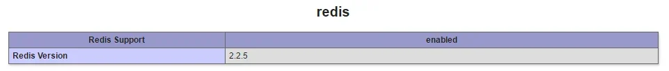

PHP Info says:
Redis Server is runing, and I can ping / pong him (redis-cli).
(installed on Ubuntu 14.04.5 LTS after apt-get update and apt-get upgrade then with apt-get install redis-server)
Your addon is the latest version (1.1.14) and no error logs in xenforo to see.

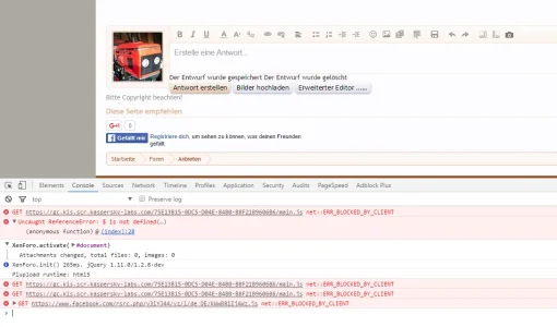

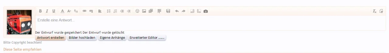

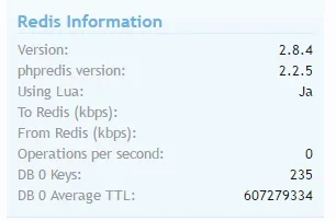

In ACP it tells me:

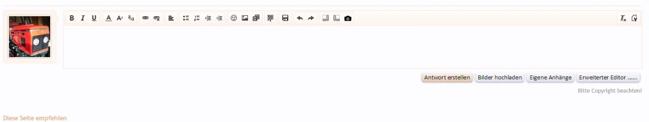

But in frontend I have now interesting errors:
1.
instead bevore with Redis Cache OFF:
or 2.
instead bevore with Redis cache OFF:
:eek:
A redis-cli FLUSHALL changes nothing...
Any Idea whats going wrong when I activate Redis Cache? What will I have forget? hmm... :unsure:

In ACP it tells me:

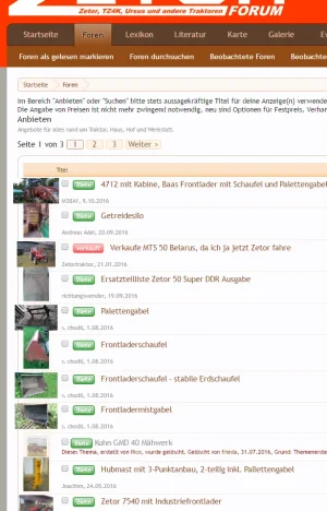

1.
or 2.
:eek:

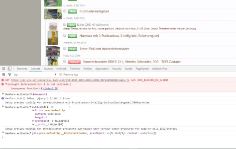

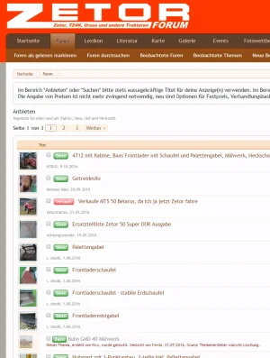

It looks like its a CSS problem when Redis caching is on.
There is likely an error in the outputed css files which gives some hint to this.
I take a look at this xenforo with the errors above and my test installation on same server, same php version, same redis (other prefix), same browser and also with Kaspersky IS aktive (but blocked) without errors.
The only difference is this error in the developer console:
Here the screens from dev console to this error:
In the other Xenforo (test installation) this error dont exist and I see no style problems.
:confused::unsure:

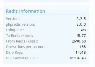

In the meantime, I installed everything on my server, and setup config.php etc but
Mehdi
This value is only populated when dealling with redis +3.0, 2.8 doesn't report those stats.
Ah, ok makes sense then.
Any other way to monitor if the thread list is transiting via redis or not ? I checked on phpRedisAdmin and I don't see it :/
