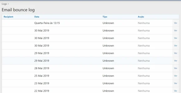

No, not at bounce message log.

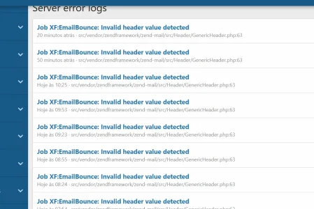

Zend\Mail\Header\Exception\InvalidArgumentException: Job XF:EmailBounce: Invalid header value detected src/vendor/zendframework/zend-mail/src/Header/GenericHeader.php:63
Generated by: Conta desconhecida 8 Jun 2019 às 11:24
