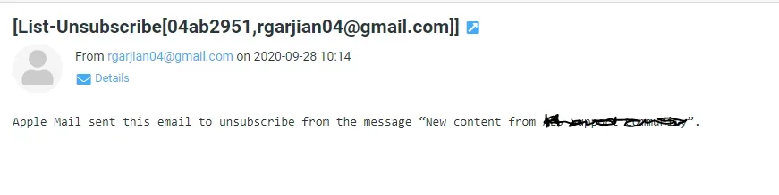

I've noticed I get these errors whenever someone "unsubscribes" using Apple Mail.
The email is never deleted from the mail inbox nor is the user marked as unsubscribing.
The only fix for me is to:
  • manually remove the email from the unsubscribe@ email account (so it doesn't continually trigger an error every time the cron runs)
  • manually unsubscribe the user in the XF user administration
Here's what the email always looks like:
The changes in 2.2 will help with the "manually remove the email" part, so it won't get stuck.
But if you still have the full, raw version of the email (including all of the headers as they were received), can you send it to me (via a conversation)? This will allow me to confirm the contents of the invalid header.
