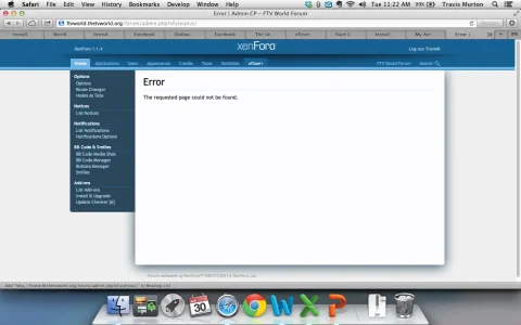

EDIT: When clicking the Admin CP tab at the top I get:
A controller for the route path xfuserplus/ was not found.
Zend_Db_Statement_Mysqli_Exception: Mysqli prepare error: Table '****.xfuserplus_stock' doesn't exist - library/Zend/Db/Statement/Mysqli.php:77
