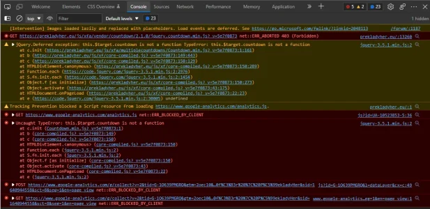

Hi,
Do you see any error if you look in Chrome in More tools > Developer console ?
Well there still seem to be a problem on the jquery.countdown.min.js file it's getting an error 403 as you can see from the first error.
