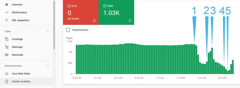

Anatoliy
1. Jul 27 - upgraded to xF 2.2 Beta 1.
2. Aug 3 - removed data-app="public" from PAGE_CONTAINER.
3. Aug 6 - upgraded to xF 2.2 Beta 2, reverted PAGE_CONTAINER.
4. Aug 13 - upgraded to xF 2.2 Beta 3.
5. Aug 15 - removed data-app="public" from PAGE_CONTAINER.
Solution

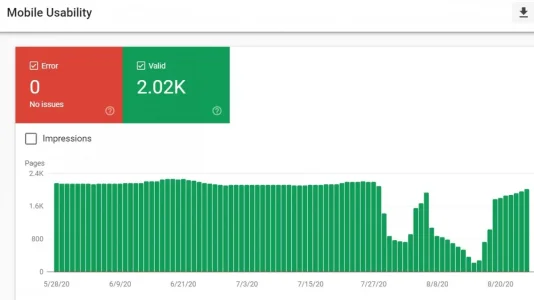

So, valid mobile pages came back to 2k. Today I upgraded to Beta 4 and put back data-app="public" in hope that this "not a bug" is fixed in Beta 4 and there will be no drop down.

so the 3rd dropdown after I put data-app="public" and the 3rd raise after I remove it will not ring any bell?

Valid mobile friendly pages went from 2.02k to 1.6k in 2 days. I know that it means nothing to you, so here's another one.
I go to Seach Console/ URL inspection/Test live url and I get "Something went wrong. If the issue persists, try again in a few hours" error for any my forum page (pages from my other sites are tested just fine). I deleted data-app="public" and url testing started to work without errors.

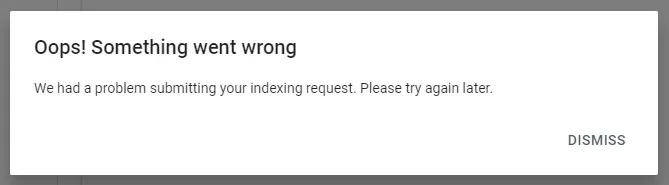

I noticed something weird today. Google Search Console shows an error when you submit a URL manually for indexing. This was not happening on 2.1. So I am guessing the same bug is affecting Google Search Console as well. Indexing is happening as usual (slow but pages do get indexed in 24 hours) so it's not like indexing is not happening otherwise. This is a minor annoyance as I like getting important new threads indexed manually (coz automatic takes time) but not a big deal.
