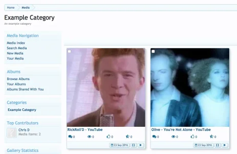

I have just done a clean installation of XF 1.5.8 with XFMG 1.1.7 and XF 1.5.1 with XFMG 1.1.1 both with the 1.5.10 patch applied.
I have tried with a couple of YouTube videos and neither give me the issue being reported:

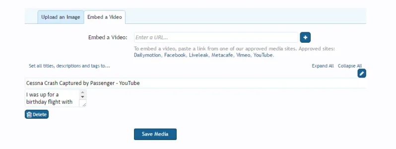

The site running 1.5.1 appears to add the file but no thumbnail is displayed - clicking Save Media doesn't save anything and the media doesn't show.

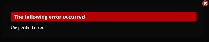

On the 1.5.8, it just pops up with "The following error occurred....".
