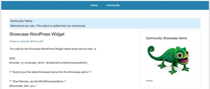

Simple Showcase Widget
The code is not complete and there are many things to be polished - but - here is a screenshot of a local development environment.
