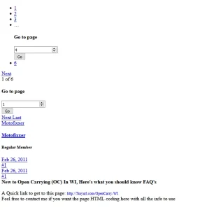

- Here is the problem ... I have a page with the following old VB4 URL:
When I access this URL, I get the page but it is all text with no styling or images (see attached screenshot).
I am sure I missed something simple but I can't figure it out. Any help would be deeply appreciated.
Thanks.

I have responded to your ticket but this thread may be the best place for community based input from others.
John Pierce
New member
I solved the issue. In case it helps anyone else, I merely added:
redirect 301 /forums/showthread.php /showthread.php
... above the rewrite rules in the .htaccess file in the forums subdirectory. That way the URL gets 'forums' removed from it BEFORE the redirect addon does its magic.
