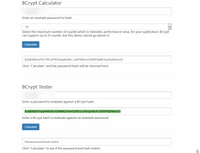

That's awfully weird, the hash seems to be 10, the tester says they match, but I do not receive the same output?

I was unfamiliar with bcrypt. Seems like the value is changing all the time, so It needs a specific testing method that can verify if the hash is the same.
