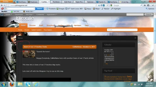

Last time I'm sure, I added an image and what I'm referring to is circled in red.
Its to two borders surrounding the content posts on the wordpress homepage? Where exactly do I get rid of those so the content can utilizes the full page. i.e like you have on your site.
And I'm trying to add another top menu, that leads to my wordpress clan app page. I want it to be a top men i.e HOME FORUM MEDIA HELP etc?

Sorry its me again......

That's because of flexile, I'll look at the css in the morning and see if I canfigure out something for you to put in the css template.

Add this to your XenDynamicEXTRA.css file for the flexile theme:
.XenDynamicMC .mainContent {
    border: none !important;
    box-shadow: none !important;
    -moz-box-shadow: none !important;
    -webkit-box-shadow: none !important;
    -khtml-box-shadow: none !important;
    padding-right: 0 !important;
    padding-left: 0 !important;
