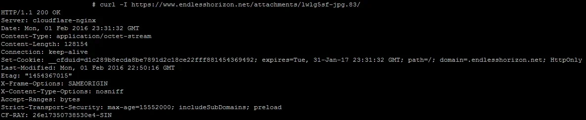

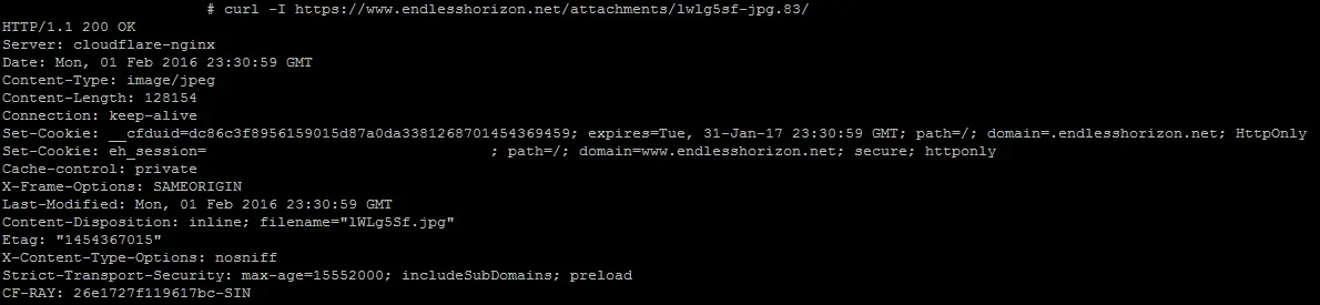

@Xon, It seems like the cause is your add-on indeed. I used curl -I to check the header (since it's faster), and here're the results when your add-on is enabled and disabled.
Add-on DISABLED (ignore the fact that I removed the session string - I didn't remember that it didn't really matter because curl would crawl the site as a guest):
Add-on ENABLED:
Also, notice how Etag stays the same?
Add-on DISABLED:
Add-on ENABLED:
I'm baffled. It sets the filename before the Etag, and my own site isn't having an issue with this.
I'll look into this more when I get off work.
@BobbyWibowo You use ngx_pagespeed right?
Seems that's causing your problem.
