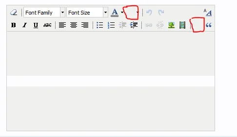

So I was trying to change the basic editor for one of my add-ons to WYSIWYG and this is what I get:
The editor is only taking less than 70% of the width, two of the buttons are gone and the text area has only one line.... am I missing something?

If it's inside the admin panel, you can set up the simple theme, the advanced theme (for both you will need to upload all plugins & themes) or to specify the XenForo theme (I think it's what missing here). Check your JS init config.

How are you loading the editor into the template?
You may need to define a custom ViewAdmin class.
Maybe refer to XenForo_ViewPublic_Account_PersonalDetails to see how the {$aboutEditor} param and its contents are passed to the relevant public template. It may be a good reference point to help work out what the requirements are to make it show.

Try to include this template "editor_js_setup" inside your customized template. The XenForo Init code for TinyMCE is there.
But on question, this TinyMCE will need pure HTML? If yes, I think you will need to create a new Init config file.
Included that template... still nothing
And, no I don't need HTML, BBCode will do the job perfectly.
I used the signature template as reference.... and I've already defined a new ViewAdmin class.

Okay, I just added the editor_css:
<xen:require css="public:editor_ui.css" />
All the icons of the editor bar are now visible, but the smilies are invisible and the grey area is still visible...
