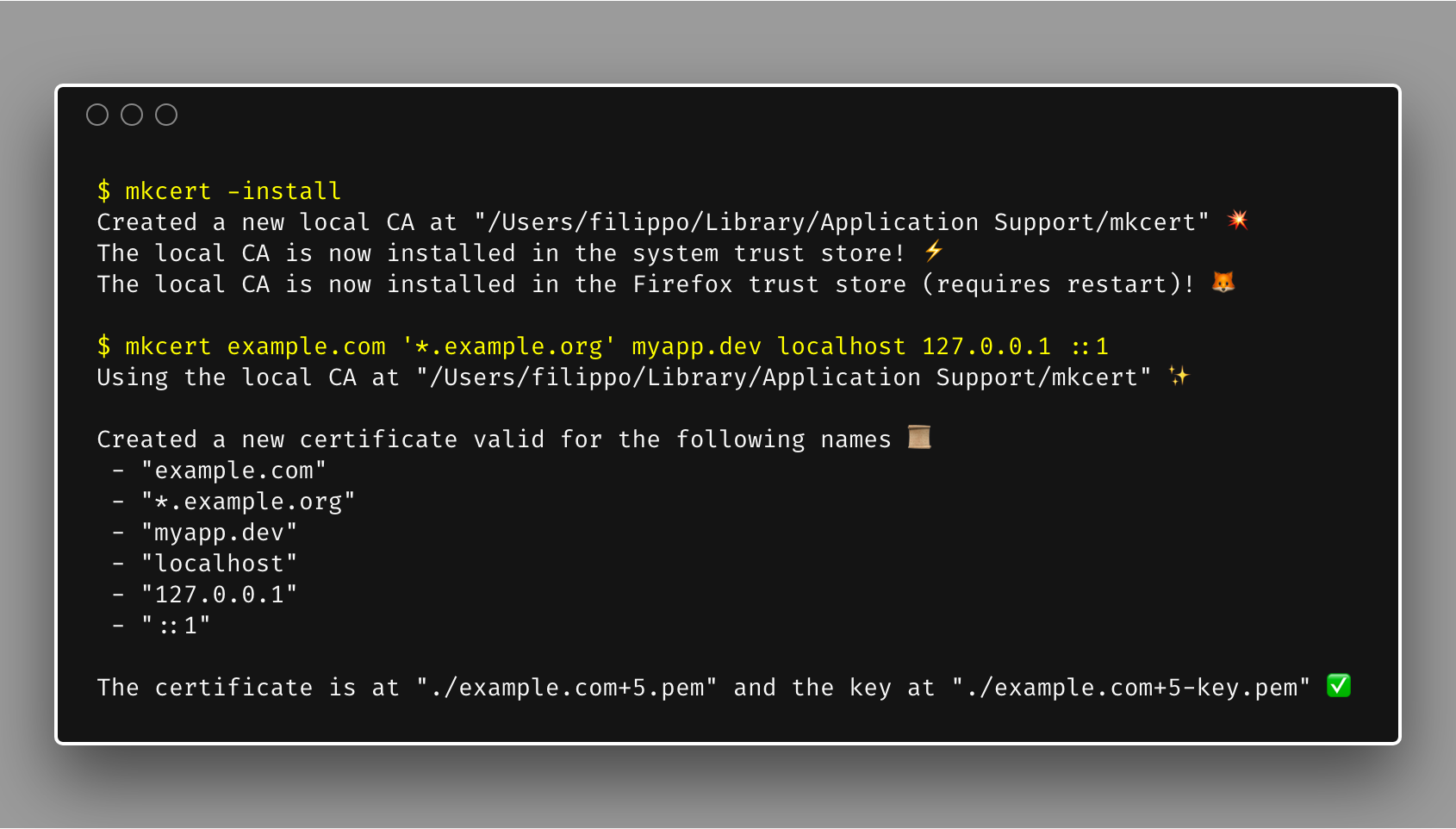

Has anyone managed to teach this annoying Firefox or other browsers that they would like to see this site?
Yes.

Do I need a real domain to get a real certificate?
What is a real domain?
Best option is to have a domain with a valid certificate, probably the easiest way:

You can't get a 'real' SSL cert for a domain you don't own.
edit: You could create your own SSL chain and set your personal computer(s) to trust it, but is it really worth all that for a dev domain?

You absolutely can, as I suggested in my post. However, the LOE is high and I hope you can see that its for a good reason. If it were easy to spoof domains and SSL certificates, it would be very easy for folks to do nefarious things.
