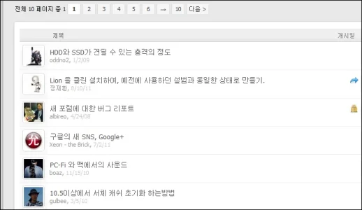

I installed XenForo on July 11, 2010. After import 6000 threads from vBulletin 3, I noticed all imported threads are shown to be started at July 11, 2010. Can I fix that?

Thank you but unlike my initial report, the real problem looks to be UNrelated with import process itself cause all date of threads started after import(even written today) are also fixed to July 11, 2010.
Strange things are:
1. Though all threads appear to be started on July 11, 2010, they are arranged correctly according to date value on thread view.

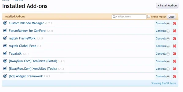

Can you list all of the add-ons you have installed?
I suspect it is one of those causing the problem as clearly the importer has nothing to do with new members.

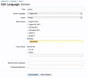

This problem DOES NOT appear when I choose default English language. This problem ONLY appears when I turn on my CUSTOM Korean language set. I created Korean language using English as parent. I just changed some phrase, not touching any deep cut.

Aha, so the dates are correct in the database, they just appear incorrectly when Korean language is selected?
Are these dates not correct though?
