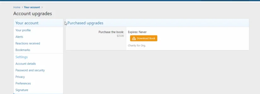

I'm with @RDR's suggestion since it's a single file.
You could do a simple edit for the account upgrades to display like this.
Before:
After:
Linking the "download book" button to an attachment that only this usergroup has access too (like his instructions).
