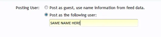

when setting up the feed....
Those sites probably have a feed per user they want feeds from (possibly directing all sources of feeds to create threads in the same forum) and are probably doing it using the option in the image above.
EQnoble
#4
I think I misunderstood you before but if from that image above when configuring your feeds you use the first option (Post as guest, use name information from feed data.) it should do exactly what (I think) you want.

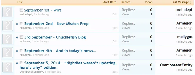

I just imported to my dev board the RSS feed from the Xen Resources News and Announcements forum:
As you can see, the thread by me at XR has been authored by my actual user account, whereas the thread by Brogan at XR has been authored as a guest (because he doesn't exist as a user on my dev board).
