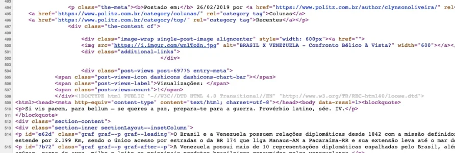

Specifically I'm talking about this:
196674
You will see the DOCTYPE stuff appear around line 508.
But the most confusing (and likely most invalid) thing is line 509 where essentially the HTML document starts again with <html> tag. This is not valid HTML. You will likely need to address this invalid HTML to ensure you're getting the correct output in things like RSS feeds and other screen scraping mechanisms.

So, the problem is the code on my WP theme.
Anyone around here know how to fix this bad codding?
