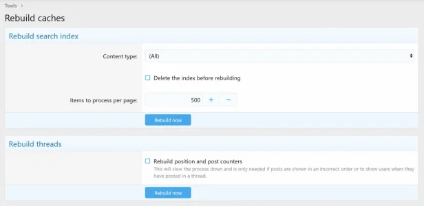

I ask again to be on the safe side. Rebuild Search Index should be clear. Rebuild thread information can then only be rebuild threads !? Should is click "Rebuild position and post counters", too?
What should I set for "Rebuild Search Index"? And how long will it take to rebuild these two indexes? Should I take the forum offline for this?
For Rebuild threads, you should tick the "rebuild position and post counters". Leaving search for the default value will be fine.
In both cases you should be able to run it without taking the forum offline, it will just take a little while.
Thread rebuild worked fine. With Rebuild Cache, after about 2.7 million posts, I only have a white screen and nothing happens. Overall, both rebuilds took a long time together. Almost 90 minutes to the white screen. The display of the postings of the individual members under "WhoReplied" is still incorrect or is not displayed at all. Should I restart and perform the rebuild cache again?
Note: I reloaded the white page, then the rebuild cache process suddenly continued and was completed. Now everything seems to be working as far as I can tell. :)
