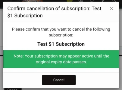

I might do a test and see. I'll report back.
Appears so!!! I'm leaving it active to see what happens when it renews tomorrow.
I really wish an email would be sent out warning that the card is about to be charged to improve member relations.
Looking through the code, Stripe does an API call to cancel the subscription but doesn't do anything with the actual purchased item, and the Cancel button for PayPal purchased upgrades links to https://www.paypal.com/cgi-bin/webscr?cmd=_manage-paylist. So the upgrade would expire via the cron that runs, and nothing would come in to re-activate it. Makes sense because you're cancelling the recurring subscription, things like Netflix keep you active for the current billing period too. I would imagine any payment email would come from the payment provider rather than XF.
