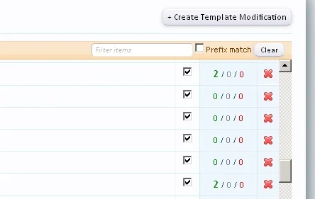

In the picture you can see some modifications are not applied. I notice that reverting a template (to remove a direct edit) will "unsave" a template modification that was applied to that specific template.
I assume this happens because of the change to the specific template. What other conditions will do this? Does a template that gets changed during an upgrade do this? Or does simply upgrading "unsave" all template modifications?

I'm looking to find out what events change the template which then would cause the unsaved condition to occur.

Showing 0/0/0 would usually indicate that the template doesn't exist. If the match fails on a template, then the grey number would be incremented. (Red means applied but caused the template to be invalid.)
Unfortunately I went through the templates and resaved them last night, so the same conditions are not present for a master rebuild test.
I do have a number of templates that have GREEN (1) GREY (1) RED (0), where the master matches, but the style doesn't. This may be a result of experimenting with the TMS addon. I've decided to remove the addon completely and then delete the style and experiment some more. If I have too much trouble, I'll wipe the test forum and start over. I may be a while before I have anything useful to report.
