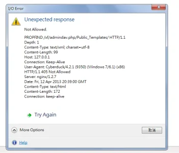

tyteen4a03 Well-known member Apr 12, 2013 #1 I can't seem to set up WebDAV. This is the error I get: This is my set up (before you ask, I did enter my correct password) Debug mode is turned on.

Jake Bunce Well-known member Apr 13, 2013 #2 You might need to uncomment (remove the #) this line in the .htaccess file: Code: #RewriteRule .* - [E=HTTP_AUTHORIZATION:%{HTTP:Authorization}]

tyteen4a03 Well-known member Apr 13, 2013 #3 Jake Bunce said: You might need to uncomment (remove the #) this line in the .htaccess file: Code: #RewriteRule .* - [E=HTTP_AUTHORIZATION:%{HTTP:Authorization}] Click to expand... Using nginx.

Mike XenForo developer Staff member Apr 23, 2013 #5 Probably need https://github.com/arut/nginx-dav-ext-module
