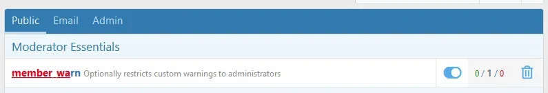

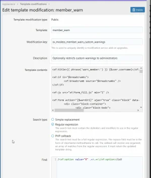

Looks like one of your other template modifications is breaking this one on member_warn, causing the Points and Points Expiry options to display even when "Limit Custom Warnings to Admins" is set to yes.
@Xon
This is deliberate in some ways.
Warning Improvements has a much more robust way to limit the custom warning by limiting by group who can interact with a group of warnings as Warning Improvements actually allows you to configure any warning to work like the Custom Warning, and lets you pre-configure the Custom Warning to boot.
