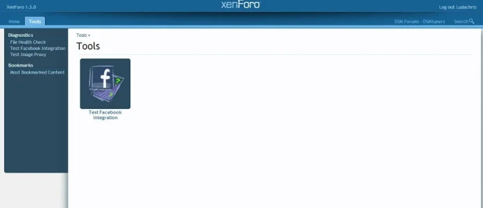

This is what my admincp looks like (attached). This same thing happened the last time I did a test import using this importer. I can't access the logs, let alone much else. And yes, I'm set as a superadmin in config.php. I also cannot log in to the front end. It just keeps looping saying I need to log in.

I confirmed that the source db has nearly 4 million records in the post table. The Export.php script is not exporting them. And as I posted above, the admincp is displaying strangely so I can't view any logs. I logged into phpmyadmin and checked the server log table. When I load the admincp this error info shows up:
Fatal Error: Class name must be a valid object or a string
library/XenForo/Model/Node.php
#0 [internal function]: XenForo_Application::handleFatalError()
#1 {main}
hold on.... might have something here. Looks like I deleted the -u and -p in front of the source db user info. I am running Export.php again and it's taking quite a bit longer than it has been in the past. I had a feeling it was something simple like that which I screwed up, though the errors sure were strange. Hopefully it goes smooth from here!
