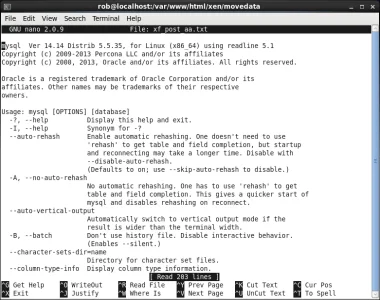

Hi. I've been attempting to get this working however I get the following error:
exporting posts...
postssh: aBULW: command not found
sh: /home/sites/mixspace/public_html/importData/xf_post.txt: No such file or directory
rm: cannot remove `/home/sites/mixspace/public_html/importData/xf_post_*': No such file or directory
wc: /home/sites/mixspace/public_html/importData/xf_post.txt: No such file or directory
(0 records in 0.01s)...
split: cannot open `/home/sites/mixspace/public_html/importData/xf_post.txt' for reading: No such file or directory
An exception occurred: unlink(/home/sites/mixspace/public_html/importData/xf_post.txt): No such file or directory in /home/mixspace/public_html/Export.php on line 821
#0 [internal function]: XenForo_Application::handlePhpError(2, 'unlink(/home/si...', '/home/mixspace/...', 821, Array)
#1 /home/mixspace/public_html/Export.php(821): unlink('/home/sites/mix...')
#2 /home/mixspace/public_html/Export.php(1900): DigitalPointExporter->posts()
#3 {main}
It's the first time running but it's saying the files are missing?

[While you're waiting for more competent replies!] I think it's normal to have 'No such file or directory' warnings on first run; I think the exporter tries to remove any intermediate files written in previous-runs when a selection is made - although I'm clearly no expert in this!
Again, with the caution that I'm no expert (I seem to be able only to export MySQL quick-help with the script!), I'd suggest that perhaps the 'postssh: aBULW: command not found' line is more of a problem - exception handling might be an issue too; I might be getting the wrong end of the stick, but it appears to be dying because previously written intermediate files aren't present - which seems strange.
Again, please take all the above with a pinch of salt - I'm a MySQL/PHP fiddler, some distance short of being fluent, and a long way from being a guru! - Maybe it's a useful perspective, maybe it's nonsense :/

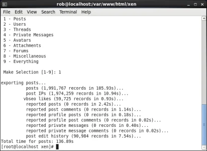

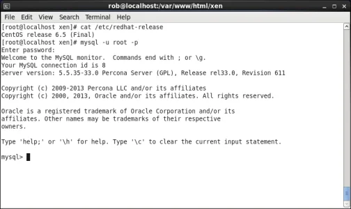

@Slavik:
I built two new clean CentOS 6.5 VMs, the first - CentOS 6.5, updates to out-of-the-box packages complete, latest stable LAMP from EPEL/Remi repos - As previously, I just get quick-help dumped to file.
The second was as above, but with Percona55 (from Percona's yum repo) in place of standard MySQL...
*cries*
I must be missing something crucial which is pretty low on the food chain, but as per my caution to NixFifty above, I'm not completely green, but I'm by no means a guru - I'd really appreciate any further advice you can offer.
Thanks again,
A

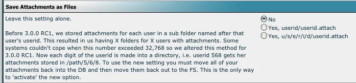

Solution for people trying to import attachments and getting the dreaded "MISSING DATA!!!" error, even though everything seems to be in order*
* meaning that the folder path is ok and has the / at the end in the export.php file + the user and group permissions are set accordingly
There are two folder structures that vBulletin can use when storing attachments in the filesystem:
1. The default one that looks like
PHP:
/attachment_folder/u/s/e/r/i/d/{file-id}.attach
So if the userid is 1234, the attachment path for a file will be /public_html/attachment_folder/1/2/3/4/1.attach.
This is what both the official importer and the Big Board Importer (BBI) look for by default.
2. A legacy one, from times long forgotten, where the user id isn't broken up into digits sub-folders and looks like
PHP:
/{path-you-set-in-the-vbulletin-options}/userid/{file-id}.attach
So in the real world it would translate to /public_html/attachment_folder/1234/1.attach
Since the BBI doesn't recognize the #2 folder structure by default, you'll get the MISSING DATA!!! error.
Thankfully, @Mike provided us with a solution for the default importer which we then applied to the BBI:
1. Open the export.php file
2. Go to line 1307 to find the following code block:
PHP:
if (self::$attachFile AND file_exists(self::$attachFile . implode('/', preg_split('//', $attachment['user_id'],  -1, PREG_SPLIT_NO_EMPTY)) . '/' . strval($attachment['filesysid']) . '.attach'))
                    $attachment['file'] = file_get_contents(self::$attachFile . implode('/', preg_split('//', $attachment['user_id'],  -1, PREG_SPLIT_NO_EMPTY)) . '/' . strval($attachment['filesysid']) . '.attach');
                else
3. Replace said code block with:
PHP:
if (self::$attachFile AND file_exists(self::$attachFile . '/' . $attachment['user_id'] . '/' . strval($attachment['filesysid']) . '.attach'))
                    $attachment['file'] = file_get_contents(self::$attachFile . '/' . $attachment['user_id'] . '/' . strval($attachment['filesysid']) . '.attach');
                else
4. Profit
For those who want to understand what we did, we changed the
PHP:
code (the one that tells the importer to "break apart" the user id when creating the attachment path) with
PHP:
thus telling the importer to read the user id whole.

That particular attachment scheme is from pre-release versions of vB 3.0 (ie very old and very rare). This is actually explained in the vB Admin CP when you enable debug mode to access hidden settings:
As you discovered, this importer doesn't account for this possibility. It is very unlikely that anyone else will ever need your fix, but it's legitimate none-the-less. :)

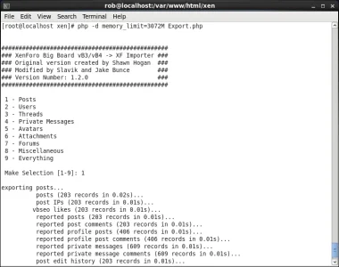

Woah there. Delay that. Don't sweat over a VM on my account just yet.
The penny has just dropped...
First of all, an admission... I'm not "A"; in actual fact, I'm R(ob) [windowtitle on terminal screenies might've given that one up, anyway] - Adam's right-hand and down-a-bit man; Adam owns the site, buys the stuff, and tinkers with things. I'm the SSH urchin. It's normally easier just to use his credentials and sign A than explain it all.
He'd dropped the two script files into our 'live' XenForo installation before I was roped in, and since then, I've been working with those. Scratching my head really hard about this, I thought I'd see if I could get hold of the original package and start from the beginning - just in case.
It's at that point I noticed that in the section of your script where parameters are entered, the database user & password variables need to have the command syntax inside their values.
I feel 10% shame, and 90% frustration (which I'll be airing to Adam at my first opportunity!).
I'm about to put all the details into the Exporter from scratch, and run again - I'm sure you'll agree it's not unreasonable to expect I'll get over the first hurdle now!
My sincerest apologies for posting what's turned out to be a red-herring issue; although I can't help thinking that sticking the -u/-p syntax in the variables' values is pretty dirty :p maybe if you update the script in future, you might append the parameters to pre-formatted syntax.
Once again, my apologies; and rest assured Adam will be made to feel the pain of all our wasted time!
R
