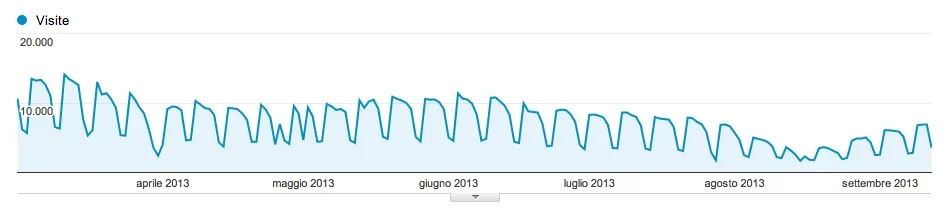

Iv'e just migrated a forum from vB4 to xF 1.5 in april... and the indexed pages are decreased a lot.
The forum count 36.000+ users and 150.000 posts.
Any advice?

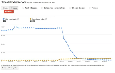

This is the graph with "blocked by robot" in orange...
As you can see, only 5/6.000 urls are blocked by robots.txt...
Where are the other 70/80.000 URL's? :(

Actually you board is (now) at PROPIT.IT not at www.propit.it as far as google is concerned
the indexed page graph you're showing is probably referring to www.propit, you probably did change something in your config (remove www) along with swtiching to XF
Currently you clearly have double content, www and without WWW serve the same thing ( bad)
site: propit.it report 134K result
site:www.propit.it reports... 5000 rsults, and lowering at each reload.
You're in a double content situation, and google chose to index "propit.it" for whatever reasons. It probably punished you for double content. The migration probably didn't help either.
