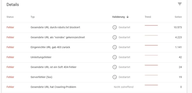

If you open a topic in the search console, e.g. cover, you will see in my language:
If you click on an error type here, further details will open. A graphic shows you how many errors occur and below it links to individual incidents. Leave the mouse on such a link and a popup will show you a magnifying glass so that you can scan the link, you can open the link in a new browser tab, or copy the link to the clipboard. If you click on such a link directly, a window with further information almost always opens on the right ...
The whole applies to each area from the main overview ...
The topic is extensive and, depending on the situation, difficult. Therefore, you should deal with the GSC. Here is a link ...
