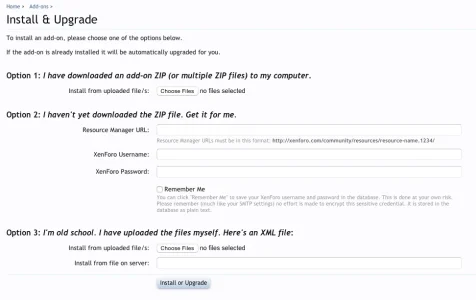

Did you by any chance try to install the mod using the AddonInstaller modification? It's not compatible with VaultWiki. You have to follow the VaultWiki install instructions here: https://www.vaultwiki.org/manual/VaultWiki-4-Manual/VW4:Running-the-VaultWiki-Install-ScriptThere was a blank index.html file added to my forum root. Very strange. Anyway, I'd like to try VaultWiki, but currently can't do it because of this error.
I used Home > Add-ons > Install & Upgrade. I'm not sure if that is a modification or not. The screen looks like this:Did you by any chance try to install the mod using the AddonInstaller modification?

@Chris D has worked out the issue installing VaultWiki via his Add-on Installer in the next release of his add-on. @L30N, once you update the Add-on Installer to that release, that should resolve the issue you were facing installing VaultWiki.I have fixed the issue with installing VaultWiki in the latest version.
My add-on LOVES to see an upload directory. If it sees an upload directory, as is common with most XF add-ons, it knows the intention is to upload the contents of the upload directory to the root of XenForo.
That's all good until it finds ANOTHER one several directories deeper...
In the next version, I have changed the behaviour so that duplicate folder names are ignored, so only the first folder it finds that is allowed is used.
