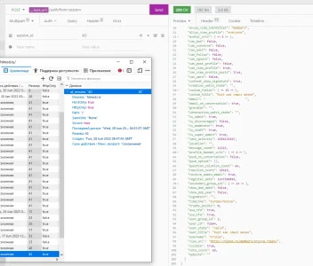

The issue I'm running into now is how to get the user id from Xenforo (in any way) to use it with the Laravel API call
Just call REST API method /auth/from-session
It returns many information with user_id:
