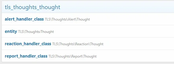

I have setup the following content type for the alert handler class:

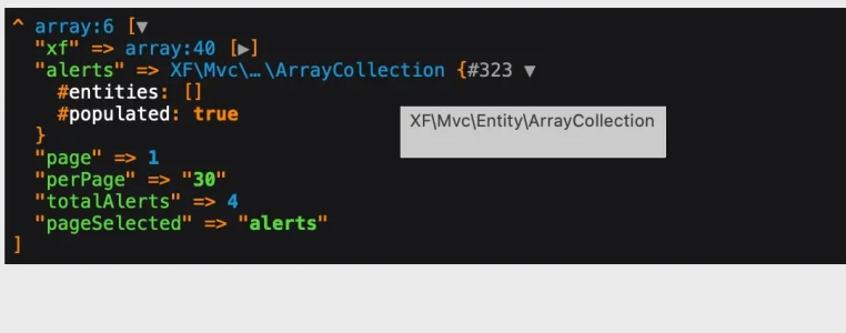

The alert is being added to the database and the bubble is showing the alert as sent correctly, but then showing no new alerts when accessed.

I think this will be leaving a clue in the server error log. If it isn’t, if you navigate to the Alerts page directly (not the popup) it should have a message displayed on screen.
You are sending with the content_type tls_thoughts, so the template should be; alert_tls_thoughts_new_thought.
UserAlert::canView returns false if there is no content, so TLS\Thoughts\Alert\Thought::getContent will need to return an empty entity (with a canView method that returns true).
Alternative; you can just use the content type user with the custom action and re-use the existing User alert handler.
The alert should also be link to your add-on via the dependsOnAddOnId attribute in the $options argument (ie the one with autoRead)
Thanks to you both.
I have changed the content_type to user as @Xon recommended and linked it to my addon using dependsOnAddOnId and all is now working.
