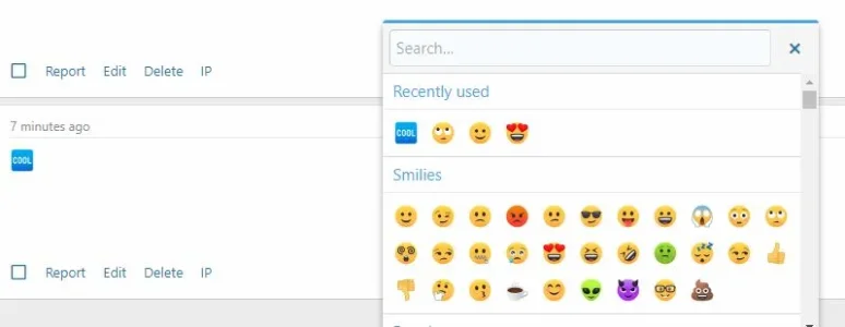

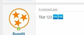

I have the EmojiOne option checked in the AdminCP. I'm confused why the smile in the AdminCP and in the editor shows up as the "cool" face, but when you post it actual renders as the "cool button".
This is happening because the cool smilie and the emoji overlap with short codes. I believe that strictly speaking we prioritize smilies over emoji, but when it comes to short code conversion, we don't consider the overlap. We likely need to not convert emoji short codes that are also smilies.
Actually, technically this is documented as part of the "Convert short code to emoji / smilies", which I was going to recommend you disable. However, it may be preferable to change this behavior given some other changes made recently.
Thanks for creating this bug report . Any changes would be welcomed here, so that smilies in the editor don't get converted into unrelated emojis in post previews etc. There was some related discussion to this in the emoji HYS thread.
