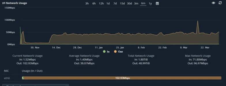

Basically, image heavy site (500GB of attachments), that was previously behind Cloudflare, with page rules to cache /attachments/ (negating permissions anyway on images cached on the edge):
You can see from the above where Cloudflare was disabled, and network usage went from 5Mbps to ~50Mbps, which shows what a good job CF itself was doing in offloading the network load (plus getting the content closer to the end users).
So offloading the images to S3 buckets would double this if the images are streamed through the hosting server.
