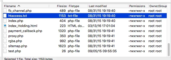

Ok, I found it in filezilla. Can I edit it in that? (Someone else installed it for me, should I ask them to sort it for me?)
Download it to your computer using your FTP program.
Open it in a text editor.
Edit it.
Upload it to the server using your FTP program (overwrite the existing file).
That is the not the .htaccess file though - it is the htacces.txt file.
The .htaccess file will be hidden, if it exists.
Otherwise just rename the htaccess.txt file to .htaccess.
This is the .htaccess.txt file, is this what I need to save as .htaccess?
