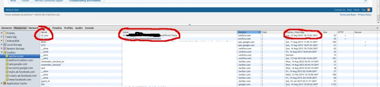

Check if the xf_user cookie is set correctly and with the right domain and expiration date. If you see at my screenshot, the cookie is set to expire 30 days from now.
