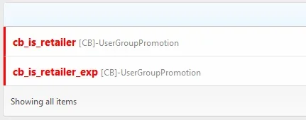

Is there a way to get rid of the Retailer stuff on registration? How do I remove this? I'm running XenForo 2.2 and cannot find where to remove this from my registration page.
What do you mean by Retailer stuff?
Meanwhile, register_form is the template where all fields and data regarding registration loading.
Sorry for the late reply.
I have already checked the register_form template and every template associated with registration. By retailer stuff I mean when someone is registering for my site at the bottom of the registration form there is this:
Registration Screen:
I changed the phrases to be blank.....
Phrases Screen:
Originally it said "Your account will be register as retailer if you select the option." or "You want to register as retailer?" don't remember which one as I've made them both blank. Retailers have absolutely nothing to do with my site.
Here is the "template_modifications.xml" code that refers to retailers, but I realize this is just to add a template which is no where to be found.

Please help me remove this retailer stuff as it has nothing to do with my site.
Thanks @LenKaiser for point the issue and i just upgrade the addon you can download the latest version and issue will be fixed.
If you have any issue or error, please let me know happy assist you.
