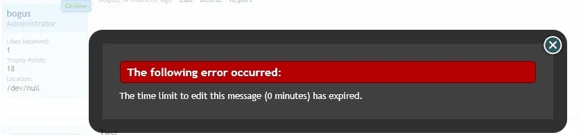

I have set up the time limit to edit a post for a separated Usergroup to unlimited in "Forum Permissions". But after i replied and try a second later to edit the post i get this.

User is in Group Supp2 (example group)
User Group Permissions - Supp2 (example group) - Forum Permissions - Time limit on editing/deleting own posts (minutes): Unlimited
Node Permissions - Admin & Supporter Category - Supp2 (example group) - Forum Permissions: Unlimited
Still can´t edit his own post. Edit post by self - set in both to allow. This Usermanagment scares me ;)
