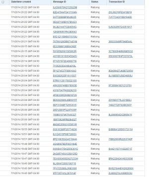

I'll check the logs...
Well I'm glad to see that the transactions aren't lost forever!
HTTP response code 500
So, something is causing the request to fail.
