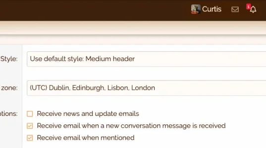

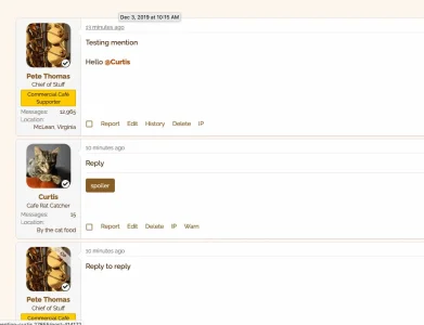

The test user is Curtis and I mentioned him at 10.15 (see screenshots below of Curtis preferences and the mention)
Curtis then replied and I replied to curtis at 10.18 so Curtis should have got an email notifying the mention at 10.15 and an email notifying my reply at 10.18

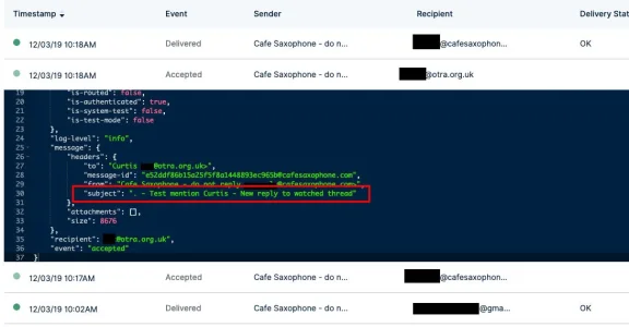

The sending logs (with full emails redacted of course)
Curtis is the @otra.org.ukaddress.
My email is @cafesaxophone.comaddress.
As you can see from logs
10.02 email to a member
10.17 email to me notifying of Curtis's reply
10.18 email to Curtis notifying him of my reply to him
So nothing regarding the mention at 10.15
