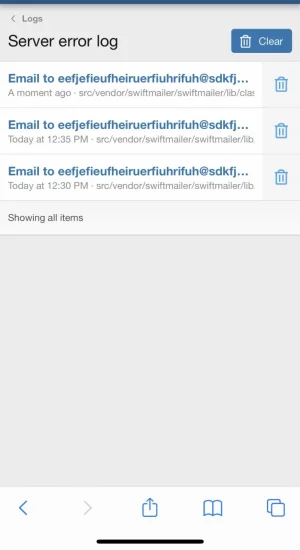

Hi when testing some emails for bounce I created some bogus emails.
Test@mydomain.com
Ahahsheueshshe@sheueuddjdus.com
I then used the conversation to send them a private conversation
Then These emails caused errors in ACP
So I deleted those users but today they showed up again in acp as errors again even though the users were deleted. ?
also if you have opened a conversation with a user and then delete that users from: user list, clicking the delete button on the right side of that user. the conversation still shows up in your dropdown with that user.?
- so possibly that is what is triggering the mail error again in ACP?
these were the errors from the bogus emails and users. they gave me an error in ACP, knowingly I had them as bogus emails to test the bounce, and started a conversation with these users to test bounce.
ran the cron to process bounced emails.. they did not show in bounced - they showed as an error..
so I deleted the users - and later on I got another error in ACP with the same emails - users that I deleted..
the conversations I had with the users I deleted, are still showing in my dropdown under view conversations.
seems if a user is deleted, the conversations should also be removed for those users? possibly those are keeping the emails for those users and are creating the error?
not sure but just my thinking.
Screen Shot 2021-03-10 at 11.51.32 AM.pngScreen Shot 2021-03-10 at 12.33.13 PM.png
I understand why these are errors and not showing in bounced - so not worried about that. just why they kept showing up after deleting the user.
I tested again today at 12:30pm then got the error. Then deleted that account at 12:32pm then got error again at 12:35pm
And now I just checked and got it again

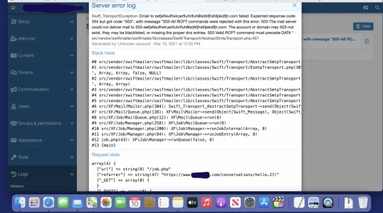

  • Swift_TransportException: Email to eefjefieufheiruerfiuhrifuh@sdkfjhsfdjskdfjh.com failed: Expected response code 354 but got code "503", with message "503-All RCPT commands were rejected with this error: 503-The mail server could not deliver mail to 503-eefjefieufheiruerfiuhrifuh@sdkfjhsfdjskdfjh.com. The account or domain may 503-not exist, they may be blacklisted, or missing the proper dns entries. 503 Valid RCPT command must precede DATA "
  • src/vendor/swiftmailer/swiftmailer/lib/classes/Swift/Transport/AbstractSmtpTransport.php:457
  • Generated by: Unknown account
  • Mar 10, 2021 at 4:08 PM
So this screenshot below shows it again! same email shows as an error almost 4 hrs later even though the user has been deleted. Almost 4 hrs ago.
  • Mar 11, 2021 at 8:37 PM
#0 src/vendor/swiftmailer/swiftmailer/lib/classes/Swift/Transport/AbstractSmtpTransport.php(341): Swift_Transport_AbstractSmtpTransport->assertResponseCode('503-All RCPT co...', Array)
#1 src/vendor/swiftmailer/swiftmailer/lib/classes/Swift/Transport/EsmtpTransport.php(305): Swift_Transport_AbstractSmtpTransport->executeCommand('DATA
', Array, Array, false, NULL)
#2 src/vendor/swiftmailer/swiftmailer/lib/classes/Swift/Transport/AbstractSmtpTransport.php(390): Swift_Transport_EsmtpTransport->executeCommand('DATA
', Array, Array)
#3 src/vendor/swiftmailer/swiftmailer/lib/classes/Swift/Transport/AbstractSmtpTransport.php(497): Swift_Transport_AbstractSmtpTransport->doDataCommand(Array)
#4 src/vendor/swiftmailer/swiftmailer/lib/classes/Swift/Transport/AbstractSmtpTransport.php(516): Swift_Transport_AbstractSmtpTransport->doMailTransaction(Object(Swift_Message), 'bounced2+437f10...', Array, Array)
#5 src/vendor/swiftmailer/swiftmailer/lib/classes/Swift/Transport/AbstractSmtpTransport.php(206): Swift_Transport_AbstractSmtpTransport->sendTo(Object(Swift_Message), 'bounced2+437f10...', Array, Array)
#6 src/XF/Mail/Mailer.php(304): Swift_Transport_AbstractSmtpTransport->send(Object(Swift_Message), Array)
#7 src/XF/Mail/Queue.php(138): XF\Mail\Mailer->send(Object(Swift_Message), Object(Swift_SmtpTransport), Array)
#8 src/XF/Job/MailQueue.php(12): XF\Mail\Queue->run(7.78895)
#9 src/XF/Job/Manager.php(258): XF\Job\MailQueue->run(7.78895)
#10 src/XF/Job/Manager.php(200): XF\Job\Manager->runJobInternal(Array, 7.78895)
#11 src/XF/Job/Manager.php(84): XF\Job\Manager->runJobEntry(Array, 7.78895)
#12 job.php(43): XF\Job\Manager->runQueue(false, 8)
#13 {main}

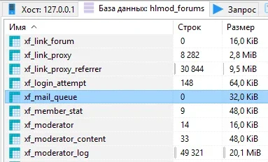

I also took a look in mysql Database but just peeked and didn't find anything that I could see.. but im not the best in mysql?

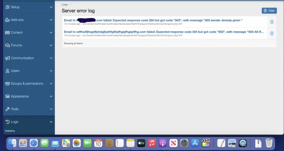

Ultimately, I think we're going to have to call this a server issue as we're not really expecting the SMTP server to error and reject the mail because the domain doesn't seem to resolve (which could potentially be a temporary error). This may be related to the specific configuration settings of your SMTP server. (We would expect mail such as this to be accepted by the server and for the SMTP server to attempt delivery before potentially returning a bounce message after the fact.)
If we get an error, we will re-enqueue the mail and try to re-send it on the assumption that the error likely came from an issue that you can resolve or which is temporary (such as authentication/connectivity failing).
There may be something to investigate with the second error being caused by the first, though if the first error didn't happen, then the subsequent one wouldn't be triggered.
On a side note, it sounds ilke you might be connecting to the SMTP server that's on the same server as the site itself. In that situation, it's likely simpler and more performant to simply use the built-in PHP/local mail system.
This issue is not the SMTP server. The issue is an email that does not resolve ie ahahshd@ajajajs.com does not bounce.
if it were ahahajsjseieh@gmail.com it hard bounced and stops retrying. Or any domain that resolves. So wish there was a way to hard bounce non existing emails.
how many times will it retry can we get a setting to retry X amount of time and then hard bounce. Or stop the re-send. Or another log in ACP that shows what’s the enqueue and a clear button to remove the queue instead of going to database to clear it.
Yes.
Yes I have setup mail.mydomain.com port 465
But - Will the automatic bounced and unsubscribe still work? In ACP. Cause I thought I read you needed to send with SMTP -TLS SSL or that option won’t work. Is php/local mail system use TLS SSL when sending emails?
Unless I read this wrong.
I don't think so as there is no bounce.
As Mike already pointed out, I think this is a configuration usse - a mailserver on a submission port (465) IMHO should not respond with a 503 (which is meant for a protocol error) just because the recipient domain does not resolve.
