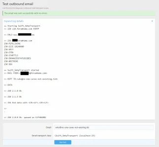

but also here isa test from the test Mail in ACP
++ Starting Swift_SmtpTransport
<< 220-server1.mydomain.com ESMTP Exim 4.94 #2 Fri, 12 Mar 2021 11:45:08 -0600
220-We do not authorize the use of this system to transport unsolicited,
220 and/or bulk e-mail.
>> EHLO www.mydomain.com
<< 250-server1.mydomain.com Hello www.mydomain.com [nn.nn.nn.nn]
250-SIZE 52428800
250-8BITMIME
250-PIPELINING
250-X_PIPE_CONNECT
250-AUTH PLAIN LOGIN
250-STARTTLS
250 HELP
>> STARTTLS
<< 220 TLS go ahead
250-SIZE 52428800
250-8BITMIME
250-PIPELINING
250-X_PIPE_CONNECT
250 HELP
>> AUTH LOGIN
<< 334 VXNlcm5hbWU6
>> bm9yZXBseUB0YWxrd2FnLmNvbQ==
<< 334 UGFzc3dvcmQ6
>> U2NhdGFNYWxha2FAMTJAMTI=
<< 235 Authentication succeeded
++ Swift_SmtpTransport started
>> MAIL FROM:<bounced2+425c55d6+aksdjhakdjhaskdjakdsjh=aksjdhaksjdhkajsdh.com@mydomain.com>
>> RCPT TO:<aksdjhakdjhaskdjakdsjh@aksjdhaksjdhkajsdh.com>
>> DATA
<< 250 OK
<< 550-The mail server could not deliver mail to
550-aksdjhakdjhaskdjakdsjh@aksjdhaksjdhkajsdh.com.  The account or domain may
550 not exist, they may be blacklisted, or missing the proper dns entries.
!! Expected response code 250/251/252 but got code "550", with message "550-The mail server could not deliver mail to
" (code: 550)
<< 503-All RCPT commands were rejected with this error:
503-The mail server could not deliver mail to
503-aksdjhakdjhaskdjakdsjh@aksjdhaksjdhkajsdh.com.  The account or domain may
503-not exist, they may be blacklisted, or missing the proper dns entries.
503 Valid RCPT command must precede DATA
!! Expected response code 354 but got code "503", with message "503-All RCPT commands were rejected with this error:
" (code: 503)

That does not function like
Post fix.
Started getting this error now and it's increasing daily..
Swift_TransportException: Email to failed: Expected response code 354 but got code "503", with message "503-All RCPT commands were rejected with this error: 503-The mail server could not deliver mail to . 503-The account or domain may not exist, they may be blacklisted, or missing 503-the proper dns entries. 503 Valid RCPT command must precede DATA "
Stack trace​
#0 src/vendor/swiftmailer/swiftmailer/lib/classes/Swift/Transport/AbstractSmtpTransport.php(344): Swift_Transport_AbstractSmtpTransport->assertResponseCode('503-All RCPT co...', Array)
#1 src/vendor/swiftmailer/swiftmailer/lib/classes/Swift/Transport/EsmtpTransport.php(305): Swift_Transport_AbstractSmtpTransport->executeCommand('DATA
', Array, Array, false, NULL)
#2 src/vendor/swiftmailer/swiftmailer/lib/classes/Swift/Transport/AbstractSmtpTransport.php(392): Swift_Transport_EsmtpTransport->executeCommand('DATA
', Array, Array)
#3 src/vendor/swiftmailer/swiftmailer/lib/classes/Swift/Transport/AbstractSmtpTransport.php(499): Swift_Transport_AbstractSmtpTransport->doDataCommand(Array)
#4 src/vendor/swiftmailer/swiftmailer/lib/classes/Swift/Transport/AbstractSmtpTransport.php(518): Swift_Transport_AbstractSmtpTransport->doMailTransaction(Object(Swift_Message), 'noreply@tami...', Array, Array)
#5 src/vendor/swiftmailer/swiftmailer/lib/classes/Swift/Transport/AbstractSmtpTransport.php(206): Swift_Transport_AbstractSmtpTransport->sendTo(Object(Swift_Message), 'noreply@tami...', Array, Array)
#6 src/XF/Mail/Mailer.php(306): Swift_Transport_AbstractSmtpTransport->send(Object(Swift_Message), Array)
#7 src/XF/Mail/Queue.php(148): XF\Mail\Mailer->send(Object(Swift_Message), Object(XF\Mail\SmtpTransport), Array)
#8 src/XF/Job/MailQueue.php(12): XF\Mail\Queue->run(8)
#9 src/XF/Job/Manager.php(260): XF\Job\MailQueue->run(8)
#10 src/XF/Job/Manager.php(202): XF\Job\Manager->runJobInternal(Array, 8)
#11 src/XF/Job/Manager.php(86): XF\Job\Manager->runJobEntry(Array, 8)
#12 job.php(43): XF\Job\Manager->runQueue(false, 8)
#13 {main}
