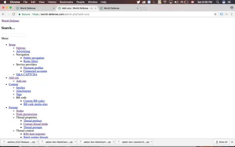

here is what I got after trying to upgrade this add-on. It completely ****ed up my entire site.
There should be some errors in the admincp, which is kinda important if I am to have a chance to debug this.
