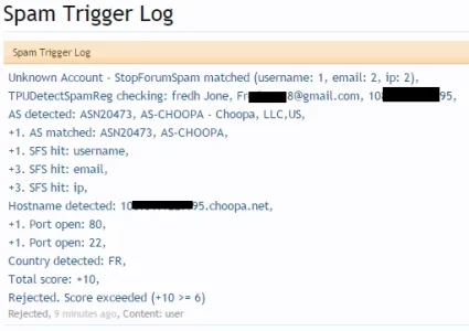

HA, just as I wrote the above I caught one I have never run into before, france lol. Dedicated server host:
Because I have my SFS email and IP set to ad +3 each it auto rejected. However AS-CHOOPA was in the stock settings as a +1 as well.

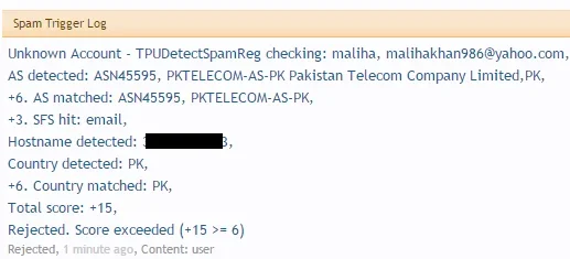

This one based on my above settings was caught:
They tried again and again with the same username, different email and kept getting rejected until they gave up.
