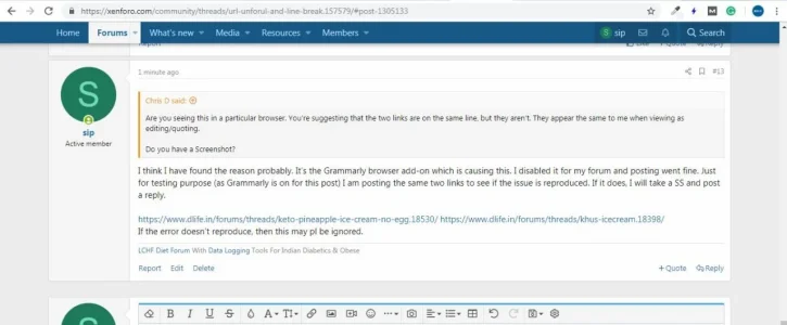

Are you seeing this in a particular browser. You’re suggesting that the two links are on the same line, but they aren’t. They appear the same to me when viewing as editing/quoting.
Do you have a Screenshot?
I think I have found the reason probably. It's the Grammarly browser add-on which is causing this. I disabled it for my forum and posting went fine. Just for testing purpose (as Grammarly is on for this post) I am posting the same two links to see if the issue is reproduced. If it does, I will take a SS and post a reply.
If the error doesn't reproduce, then this may pl be ignored.

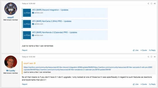

Ok it is reproduced again. Here's the screenshot as i see immediately after posting:
Browser: Chrome Version 70.0.3538.110 (Official Build) (64-bit)
190350
If I just edit and save (w/o doing anything) my previous post the line-break comes back fine.
In fact, even if there's a reply after that post the line break shows fine.

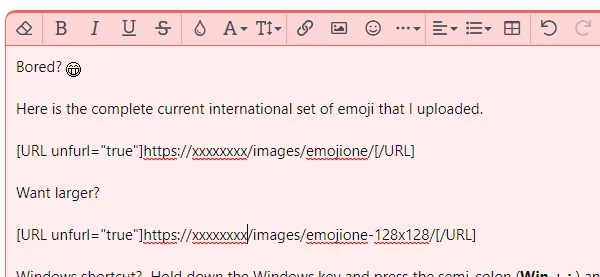

I was about to check for a report on this myself. I just made a post in our test forum where I had the post written as one line, one blank, one URL on a line by itself, one blank, one text line, one blank, one URL by itself, etc., and the line breaks after the URL eliminated the immediately following blank lines. If your fix sorted this type of issue, it's all good. Just seemed to be related. :)
190372
Which rendered as this:
190373
