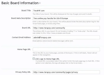

I am a bit confused about where I went wrong in my XF install to cause any issues with my URLs. To the best of my knowledge all addresses in my site should be prefixed with "www". My board options appear as follows:
I was informed a recent issue on my site was caused by my forums being located at http://terapvp.com/community and not http://www.terapvp.com/community. Where else is this defined during the set up process? How can I fix it so all URLs have the same format?

I was thinking that might be necessary. Before I take that step I want a better understanding of how I screwed up my XF install in the first place? If my board URL shows my address as listed in the image above, why do my forums not have the correct "www" prefix? Is there another location this is defined?
My site is not "live" as of yet, it has no google index. I would prefer to properly fix the issue as opposed to using any form of redirect.

It shows as prefixed with www for me: http://www.terapvp.com/community/portal/
Which URL are you using to navigate to your site?
If you use the non www URL then that's what will show.
If you use the www version then that one will show.
You have to use an .htaccess redirect if you want to force one or the other.
There is no other way of doing it.
