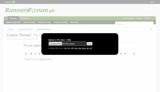

Need help. I just tried to upload file to my post but apparently it does not work. Below is the screenshot. I got no error message but every time I upload a picture or file it only gives me a long loading like what you see below.
I try to refresh the page, Log out and log in again try to upload picture but same problem. Very long loading.

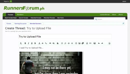

I am expecting for this result after a few loading.

Please try disabling the Flash uploader. Does it work then? If so, it may be something like mod_security interfering. This can potentially be disabled via .htaccess.

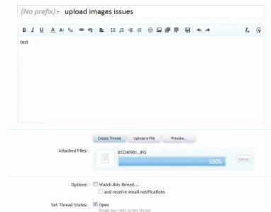

The file uploads and shows just as a file in the upload in the attached files section, it will get to 100% and then nothing happens. It's not visible, if you try to create thread and leave the page there's nothing there, no picture, just an empty post?
This is bizarre, I can upload old images from a crappy camera and it will work so it must be some file issue, but I can't find any more settings to change?
Any help is appreciated...I am just using a regular nikon camera, .jpg files. Below is a screen shot of where the software basically freezes during upload.
