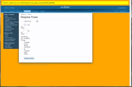

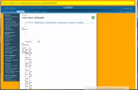

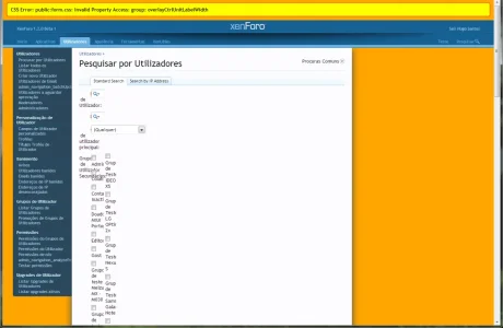

i've admin layout with errors
Screenshot?

Can you PM me (or submit a ticket) with the URL and admin CP access details? We've had this reported a few times now, though I don't see how it's possible to not be fixed in the admin CP after doing a master data import.
So after i uninstall almost all my addons and all my styles, disabled all remain adds in config and remove portuguese language, i've upgraded with some server minor errors, but admin and site style is ok now.
