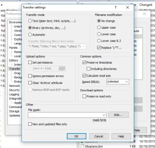

I was using WinSCP. Is there a particular FTP client I should be using? WinSCP appears to be uploading in binary by default, but maybe there's something I don't know.

I use WinSCP and don't generally have issues with it.
The out of the box settings should be fine.
I see you have cPanel so I would suggest using the File Manager app to upload the zip archive intact and extract directly on the server.
It's way quicker and not prone to transfer errors as FTP is.
