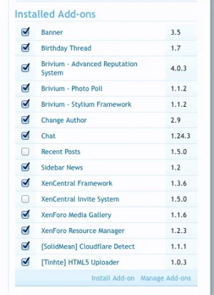

Hello, I UPGRADED Xenforo from 1.5.7 to 1.5.9 yesterday and now avatar images don’t show at all. Rebuild the outdated templates and no avail.
Any help how I could fix this would be greatly appreciated.

Screen Shot 2016-08-07 at 13.36.04.webp Screen Shot 2016-08-07 at 13.38.25.webp
