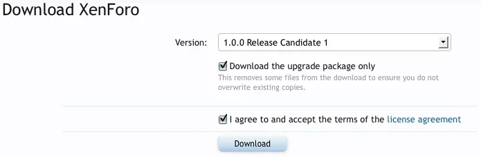

Step 1) Download xenForo
Login to the customer area and download the xenForo zip file:
http://xenforo.com/customers/
Make sure Download the upgrade package only is checked. This option omits the data and internal_data directories to ensure you don't accidentally overwrite those directories when uploading the files:
Save the zip file to your desktop. Unzip the file. Find the upload folder inside.

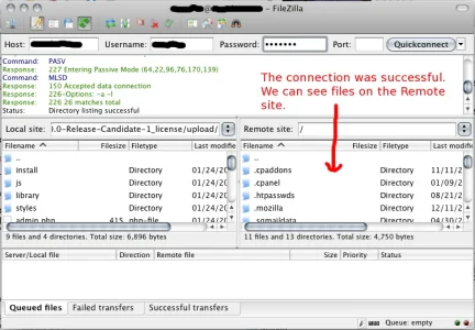

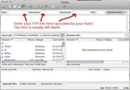

Enter your FTP info (provided by your host) into the FileZilla window:
Then click Quickconnect. If the connection is successful then you will see files listed on the right side for the Remote site:

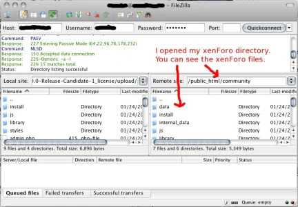

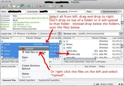

Now use the Remote site window to navigate to your xenForo directory. In my case xenForo is installed at public_html/community:
Now you need to open the aforementioned upload folder on your computer using the Local site window on the left. Select all files from inside the upload folder and drag them onto the Remote site window on the right:

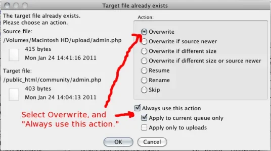

You will be prompted to overwrite the existing files.

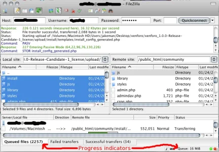

Now you will see FileZilla uploading the files. This can take 5-10 minutes:

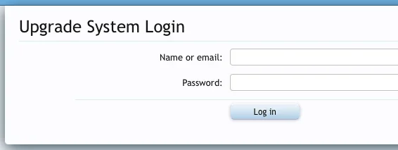

Load the install URL in your web browser. For example:
http://www.yoursite.com/community/install/
It should automatically direct you to the upgrade system. You will be asked to login using your admin account (unless you are already logged in):

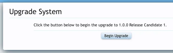

Next you will see the following screen where you need to click Begin Upgrade:

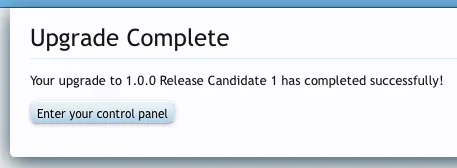

It will run the upgrade and then take you to this screen when it's done:
Click Enter your control panel and you are done. The forum will be automatically turned back on now that the upgrade is finished.
